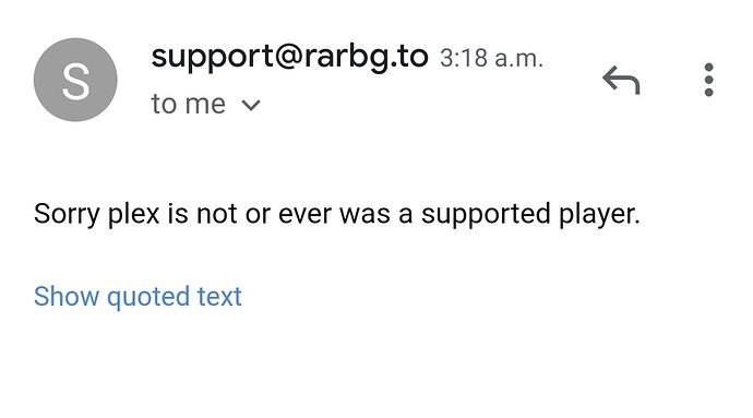

This was the reply I got from RARBG after I describe the mp4 issue we’re having with their encodes. Guess we can expect to use the temp fix until someone notices it’s been addressed in a future release.
