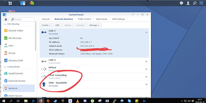

Just doesn’t work for me. I’m using a Synology NAS connected to a Unifi USG. The static IP of the server is 192.168.1.7 and the port forward is set in the USG for 32400 and on the plex server.
I set the domainaddress as you said (non certificate) so http://plex.mydomain.com:32400

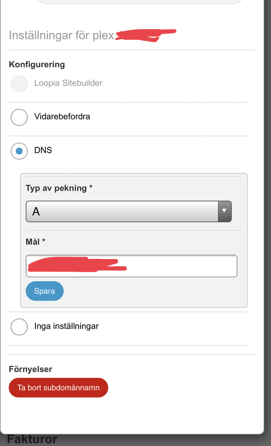

The server is also connected through NordVPN so my WAN IP in plex settings is a random one. As soon as I turn VPN off, it works, though I think it’s using the WAN IP rather than the domain. I’ve checked my DNS settings where I bought the domain and it’s pointed at my WAN IP using type A.
I’ve set secure connections to “Off” (since I don’t have a certificate)
When logging into plex.tv from a mobile device (outside LAN) it can find the server and its changes (changed the name for it to try) but it says that it’s offline. When trying to ping the server I get disconnects.
I’ve tried rebooting both the Synology server and the USG. Tried using UPnP both on and off. Nothing seems to work.
