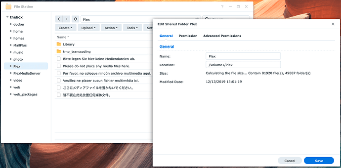

I see your DSM 6 installation.
I see TWO Plex Media Server folders.
Which is/was the working DSM 6 one ?
The “Plex” shared folder was abandoned after migrating to DSM 7.
(I didn’t have sufficient permission to remove it )

Thanks. Everything seems to be in the Plex shared folder as it should be. Screenshots below (the calculating file size was taking forever, but there is a lot in there).
I will follow the step you lay out.

I believe it’s the one that I have selected in my screenshot (as that’s the one with data from before yesterday). Possible that the other one was from one of my reinstall attempts yesterday (everything in that folder is dated as such)?
I would like you to follow the same instructions I gave Xzorba above.
After the migration, if there are issues with Plex Media Server and Plex Media Server.old then we’ll sort it out then.
