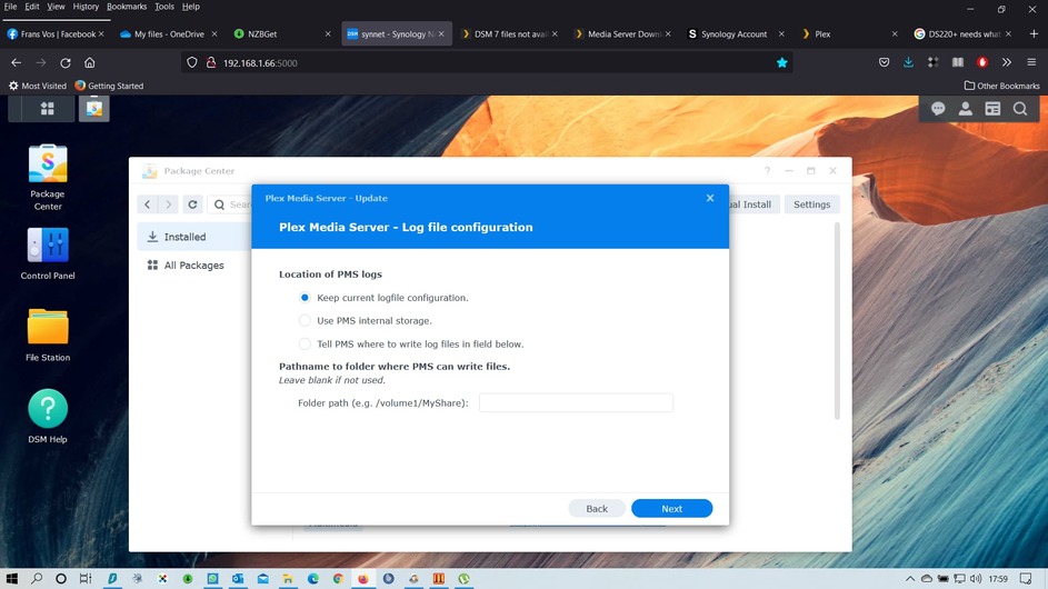

OK, then I’m still confused which one to take. I must be blond :frowning: sorry. Running my stuff on DS220+ and my laptop has 64 bit. Do I choose the Intel 64 bit or one of the ARM versions?
So can I keep current log file configuration, or should I change that?

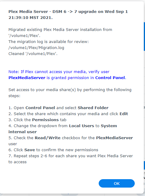

Do you remember this blue popup when you finished installing ?
If you look closely, it’s the instructions (reminder) about how to give permissions to PlexMediaServer (the new username) so it can see your media.
This sound about right?
