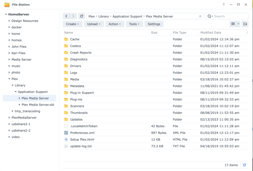

Can you confirm for me that you still have:
Plex / Library / Application Support / Plex Media Server
(Use FileStation to do this)

The Plex / Library / Application Support / Plex Media Server is still there and seems to be complete so I will try this tonight.

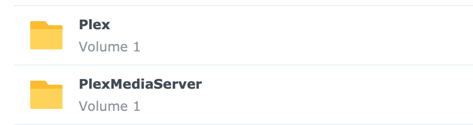

  • I now have 2 Plex shares (‘Plex’ and ‘PlexMediaServer’)
  • My original share (‘Plex’) still contains my files

Also, do you have /Plex / Library / Application Support / Plex Media Server ?

However, I still have a second, non-working ‘server’ listed in Plex, and my media files are still in ‘Plex’ (my old share) while the newly created share, ‘PlexMediaServer’ just has the app data. Are these redundancies just what I’m stuck with now or did I miss a step?
Thank you again for your help!

All I need is for you (or anyone) to stay away from the PlexMediaServer shared folder unless getting Logs, adding Plugins or making backups.
(DSM 7 took away my privileges. I can’t fix permissions when the app starts anymore. If permissions get broken, PMS on DSM 7 fails)
Ok, 2 shares, one with media and one without, seems to be the intended outcome. My OCD will just have to deal with that :slight_smile:
As for the extra server showing in Plex, I’ve manually removed it. So if that takes care of things I’ll just rebuild my home screen on all my devices around this new copy of the server. Thanks again.
@broodle
There was never supposed to be two shared folders.
(IF I had permission in DSM 7, I’d have done all that work for you)
The original intent:
  1. Movies
  2. TV
  3. Music
  4. Photos
  5. Plex (now PlexMediaServer) shared folder
