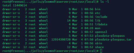

Perfect, well almost perfect. I seem to be getting an illegal group name issue when making sure the permissions are correct.
What am I doing wrong?
I’m not sure you are doing anything wrong here. When pkg installed Plex Media Server the user account “plex” and group “plex” were made. If you’re running the command from the TrueNAS shell and don’t have a “plex” group there that would explain it. You can just do it from inside the new jail’s shell and it should work then.
I was running the commands in a session using Terminus (separate desktop application), I find it’s a good app. I had a look at the accounts setup and there is no group or user with the name plex, so I take it that’s part of the issue, the other part not using the shell in TrueNAS. I’ll give it another go using shell directly from TrueNAS however, before I do. I checked the permissions from the original directory/server and they were all set to root:wheel - see below.
The permissions for the new directory/server are the same - see below.
So I guess the question I have is, given the new server is up and running perfectly, the data has been migrated across successfully, why do the permissions need to be changed to plex: plex and obviously creating a new group and user?
It’s worth noting you’re looking at the directory contents of /local right now.
I’m talking specifically about plexdata-plexpass and its contents.
The files are the Plex server data, and therefore include the database files and metadata for the server content. Plex would need to be able to update these files as you gain more server content, download posters, and edit tags on stuff, etc. Plex Media Server runs as the user “plex” and would need the ability to write to those files. Besides the normal full access to the file’s owner, your permissions right now include read and execute access for Group and Everyone (755 is that mask I believe). So Plex can read the files as they are when they were copied but cannot modify them.
TAR is supposed to maintain ACL’s I believe, so I don’t know if the applying of the chown here is absolutely necessary, I just see it as a Good Idea™ to avoid issues later if something got created by the untarring that has the wrong owner/group.
As far as the old server, if all the files in the plexdata-plexpass folder are root/wheel, it’s possible whoever made the plugin has Plex running as root (really not a good idea security-wise). But the pkg install runs as the user “plex” is the point here. If you were reading the messages when pkg installed it, it told you it was creating the user “plex” and group “plex” on the jail as part of the process. That’s why you’re having this issue trying to run chown command from the TrueNAS system’s jail, which is a whole different user and group database.
It’s the same issue people have when they are setting up a new server and for some reason PMS is not seeing the movies and TV shows they have on their storage pools. The files were uploaded via SMB or FTP and have the owner as the name of the user. I get around this by having an auxiliary ACL for the group “plex” added to my Windows file shares so files I upload get access to the group plex added, and therefore Plex Media Server can access them even though the files are still owned by me.
Edit: You’re fine to use Termius, btw. It’s what I use on my Macbook when doing stuff on the the TrueNAS system. You just have to be in the shell specific to the jail. When you connect over SSH you’re working in the TrueNAS system when you first log in. You can access the shell for the jails from it the same way you would if you were typing away on the shell on the TrueNAS GUI.

Oh right. I just checked the permissions for both the old and new jails and they are both root: wheel.
Original Plugin
New Plugin
So based on what you are saying, when I installed the new plugin, it should have set the premissions to plex:plex for the plexdata-plexpass folder? Odd that it didn’t. I’m not sure what I did wrong there.
I’d like to address the security concern you have highlighted however, unsure how to fix it. Is the solution to create a new user and group using the TrueNAS GUI. Following create a new Windows Share (SMB) via the GUI specifically for plex? If so, I’m assuming the path should be just the plexdata-plexpass folder in the new jail, so in my case that would be:
/mnt/red1/iocage/jails/plexmediaserver/root/usr/local/plexdata-plexpass.
or should I just try to reinstall and migrate again?
