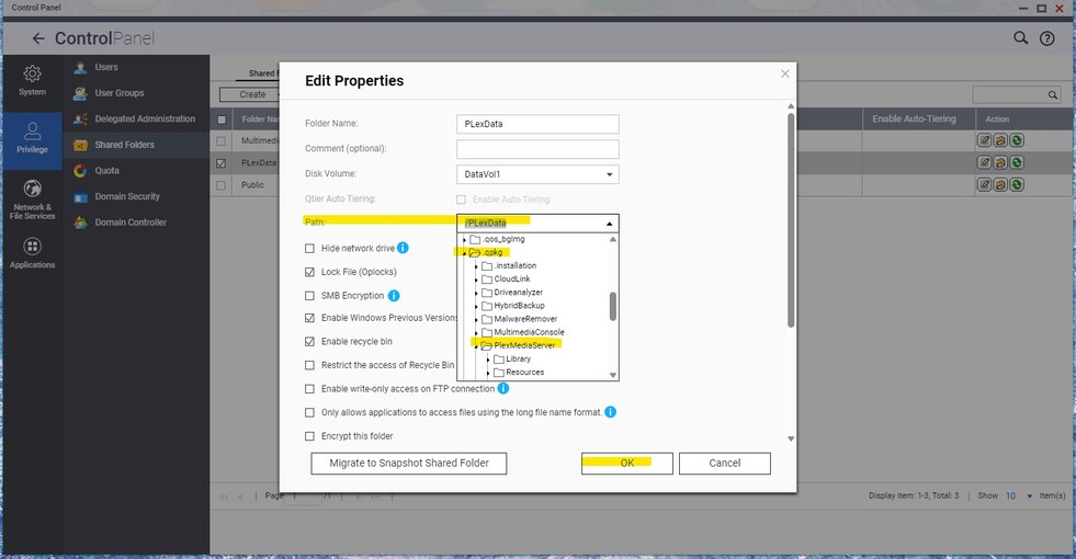

PlexData
Is the exact upper/lower case you are to use.
By doing this, PMS will use that shared folder automatically.
No manual intervention is required on your part.
In the future, should you move PMS to a different volume on the NAS. it will automatically track to that new location.
Supplemental:
This is how it looks when created.
  1. The shared folder can exist on any DataVol
  2. It will contain only one entry ; which is a link to the hidden .qpkg directory so you can use FileStation without jumping through craziness.

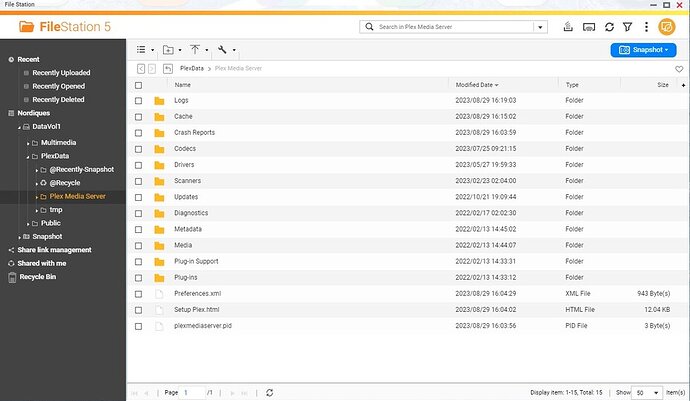

  1. Create the EMPTY PlexData shared folder anywhere you want on the first NAS
  2. Stop PMS, Start PMS, then stop it again (so we can make the backup)
  3. Open FileStation
  4. Open “PlexData” and you’ll find this:
  5. Highlight all the files (upper most button in FileStation left corner)
  6. Right-Click → Compress → Give it a name
  7. When that’s done, copy it to the new NAS (where you’ve already installed Plex)
When you copy it to the other NAS, I recommend putting it in the Public shared folder to start

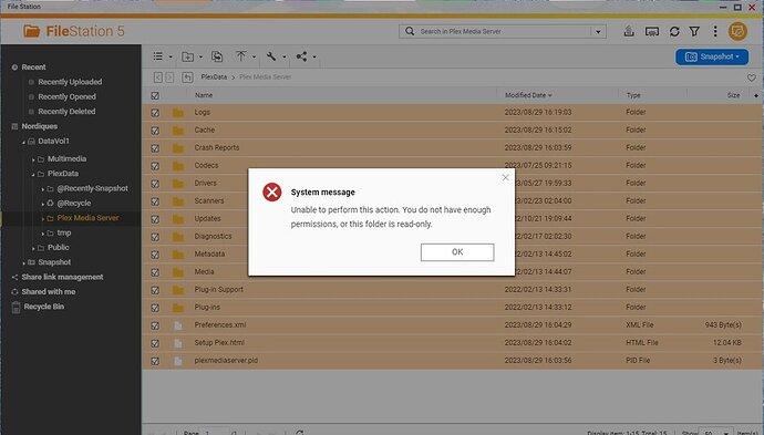

permission error
You turned off admin (per QNAP advice)
For this one step,
  1. Enable admin
  2. Give it a good password
  3. Sign in as admin
  4. Do your work
  5. Disable admin
same result… Going to call QANP on this one unless you can think of something.

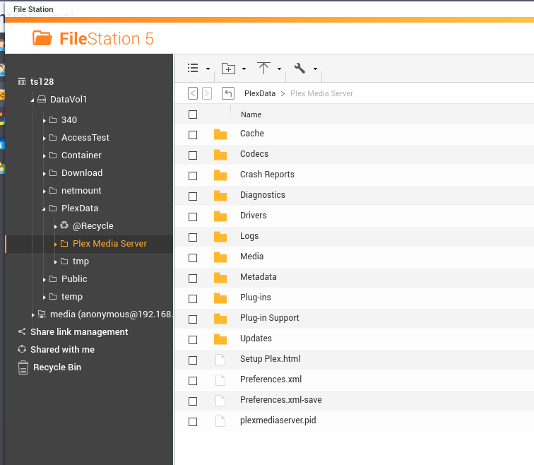

QNAP Connected, we can create, delete edit content in the “PlexData” folder , any child objects below this, denied. Vetted permissions everywhere, solid no issues.
Confirmed PMS service is stopped; QTS version 5.1.1.2491
Also confirmed, same issue on the destination NAS
Did we / I mis something?
signed in as the admin user ?
You’re not trying to access the “PlexData” over the network are you?
(it’s local access only)
