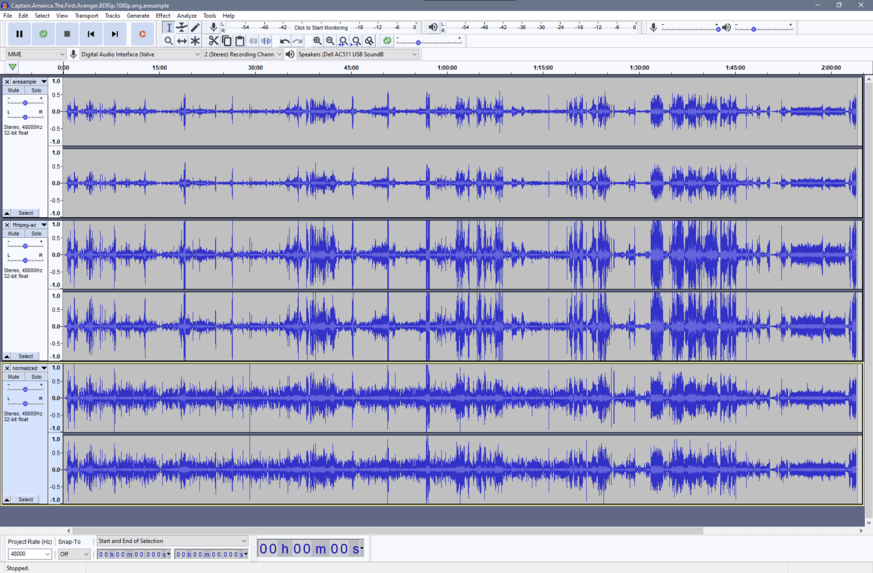

At least as of 1.20.1.3252, Plex server is using aresample with ocl=stereo to downmix 5.1 audio when playing on chromecast. But resulting audio has much lower volume of speech compared to sound effects. ffmpeg has -ac flag specifically for downmixing, which works differently from aresample filter.
To further illustrate the difference, below is a screenshot of waveforms of 3 tracks downmixed from the same source:
  1. ffmpeg -filter_complex '[0:0] aresample=async=1:ocl='stereo':rematrix_maxval=0.000000dB:osr=48000'
  2. ffmpeg -ac 2
  3. ffmpeg-normalize -e '-ac 2' (which also applies loudnorm filter)
As you can see, output of aresample is much more quiet than the other two methods.

(number in the first column is max level in each output)
It seems that it’s rematrix_maxval that is messing up the volume. loudnorm can bring it back to normal, but only if placed after aresample (and then another aresample instance is needed to get to the final desired sample rate from 192kHz).
I think I’ll just filter out rematrix_maxval from ffmpeg invocation and see if anything breaks.

Yup, removing rematrix_maxval helped with volume when downmixing, and I haven’t seen any issues.
