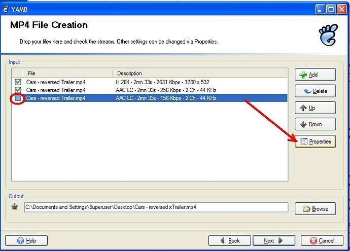

You can also use YAMB. You must get version 2.1.0.0 beta 2 (NOT 1.6).
https://www.videohelp.com/software/YAMB
From there you can un-select any track you do not want. And the best part is, it only remuxes the file so the process take a couple of minutes (or a few seconds on small files. eg, tv shows.). No need to encode or re-encode.
