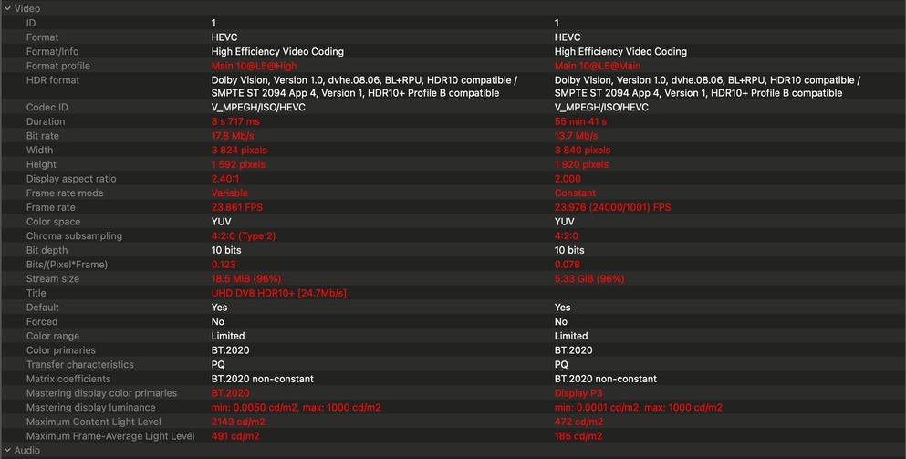

I have two different DV8/HDR10+ files. On the latest gen2 firestick 4k max, one plays back correctly as HDR10+, the other was exhibits wrapping. Kodi plays both files back incorrectly with wrapping, so I know the Plex fix here is at least partially working when HDR10+ is detected.
Comparing the two files in Media Info, they have the same HDR format. However, the file that is not playing correctly does not have the “title” field populated.
Comparing the media info in plex itself, there is mention of HDR10+ in the file that plays but none in the file that does not.
This would indicate why some folks are saying this is still not working.
