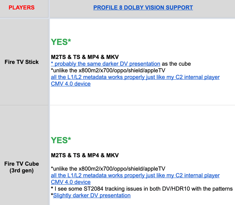

This would be an incredible solution if the Fire TV didn’t have an ST2084 tracking issue producing a darker image:
I thought about possibly trying this as well on a CCwGTV but it looks like it has issues with producing a brighter than reference image:
And then the Shield TV is too red:
