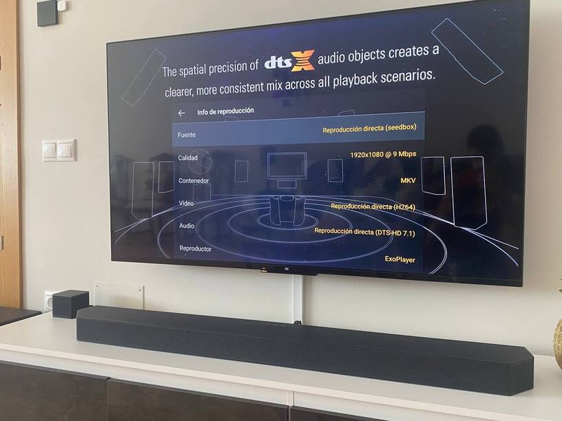

@FordGuy61 Yes, both DTS-HD 7.1 and 5.1 works in direct playback (Preproducción directa in the photo)
EDIT> if you can give me a DTS:X clip I’ll try it.
DTS-HD 7.1
DTS-HD 5.1
TrueHD

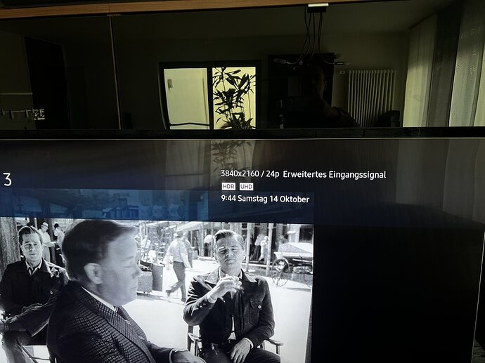

I, otherwise, cannot confirm this. I still have troubles with DTS HD MA 7.1 audio tracks which didn’t change with 7.6.5.2 and the newest Android App/ FireTV App Beta Release .
DTS (HD MA) 5.1 isn’t a problem, but DTS HD MA 7.1 is.
EDIT: I assume, you don’t have HDMI Passthrough enabled, which would explain that.

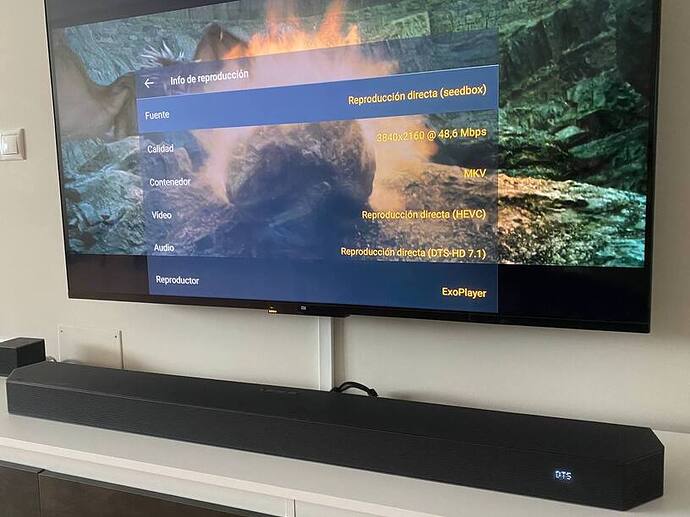

The soundbar shows DTS and Atmos, not PCM, so the passthrough is active, both in the plex App under audio, and in fire cube “best option” under audio settings.
You can see the pictures that it does not transcode anything and does not trigger PCM in the soundbar. (990C samsumg)
I can test what you need to verify it.
If you say so, I believe you, but it’s still strange. I’m clueless what I could try…
My TV is a old 2017 Samsung, which still supports decoding (or passthrough) of DTS(HD MA). The native App for Samsungs Operating System is capable to play DTS 5.1 and also up to DTS HD MA 7.1. But is limited to PCM 2.0, instead of 5.1 or 7.1 and isn’t capable of Dolby True HD/Atmos.
My Soundbar and Subwoofer (2.1) are from the German audio specialist “Teufel” and has a native DTS and Dolby Digital Decoder, but not for DTS HD. BUT: DTS HD is backward compatible to lossy DTS (Core) and it is working with DTS HD 5.1, but not with 7.1 although it should possible. With Kodi on Fire TV Cube 3rd Gen. with the GitHub AddOn Plex Kodi Connect, it is actually working, but I love the frontend of the Plex App, it’s way more comfortable and I want to get rid off Kodi/PKC as soon as possible.

Thanks for the pic. Nice that it direct plays.
Does the sound bar display DTS:X, not just DTS?
Only “DTS” is displayed on the soundbar screen for both 5.1 and 7.1 unlike dolby which shows whether it is digital, digital+ or atmos
Looks like the Cube is sending just the DTS 5.1 core audio.
The sound bar manual says it will display DTS:X if receiving DTS:X audio.
From Connecting an External Device section:
Yup, indeed only DTS-HD passthrough (basic profile) 5.1. @anonymous0815
Sorry for the confusion, It is strange that in Plex it comes out as direct playback, but then it is converted to DTS HD 5.1.
