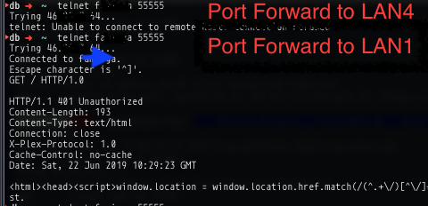

These are the results (with the Preferred network interface setting) for an external connection with only the target IP changed in the DSL Router:
13
This is clearly insane. The only change between those two telnets was changing the target IP for the Port forwarding. And the “Preferred network interface” in both cases was set to LAN4

Neither routing (via 2 Port forwards) to LAN3 not routing (via 1 Port forward) to LAN4 works. Only breaching my secure network does the trick. :sob:
