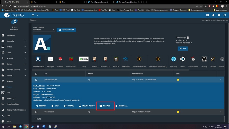

Hello, I’m on FreeNAS-11.3-U2 and trying to setup PLEX plugin.
I can connect to PLEX GUI via server IP, after login show this page
It does see the server but can’t access to it.
I tried install PLEX server on my windows it work perfectly but not on my FreeNAS jails.
