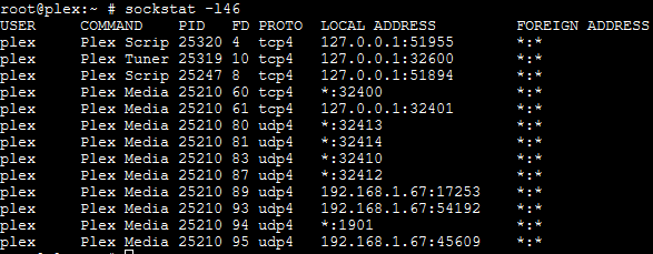

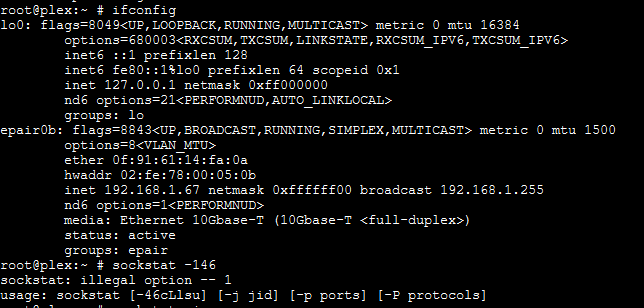

what’s the output of ifconfig and sockstat -l46?

its -l as in lowercase L not 1 :stuck_out_tongue:
But form the ifconfig info I can see DHCP is not in use!
If you want to keep things simple and easy please enabled VNET DHCP and BPF; and set any static IP config via the router DHCP reservation!

here it is, sadly I had dhcp enabled before as well didn’t work

Well that shows PMS is running and listening on 32400
So if you browser to http:/192.168.1.67:3400/web and that doesn’t work I’m not really sure what might be happening other then firewall/network issues! :man_shrugging:
