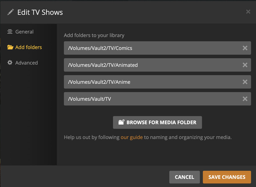

No – TV Shows for instance are at:
/Volumes/Vault/TV
/Volumes/Vault2/TV/Anime
/Volumes/Vault2/TV/Animated
/Volumes/Vault2/TV/Comics
The first is the original bucket in one DAS volume, the rest are subdivided buckets on the second DAS volume. And yet, these will be scanned a bit too frequently. I guess that’s why I was hoping that I could find the triggering event in one of the logs or something so I’d have a better idea of what was triggering all the scanning.

So, just to be clear, I have folders like these:
  • /Volumes/Vault/TV
  • /Volumes/Vault2/TV/Anime
  • /Volumes/Vault2/TV/Animated
  • /Volumes/Vault2/TV/Comics
Each of these is added to Plex independently.

I believe your paths are one level too deep
Too deep how? It’s organized exactly how that guide suggests – I just have multiple top-level folders added to Plex, because a single top-level folder was starting to get unwieldy (I have lots of content in Plex):
Multi paths are fine to use, just not one more level.
