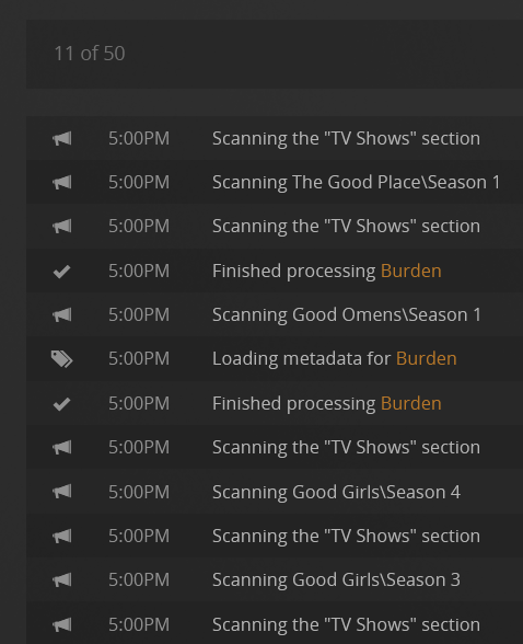

Alerts output right now as PMS is preforming an automated scan of my TV library:

When a scan like this is running, the Activity indicator on the PlexWeb main page shows a progress circle for each folder - further indicating that PMS is running an individual scan process on each folder.
So - the question is why does PMS queue up a individual scan for each and every folder/sub-folder on each of the SMB shares?

Interesting thing I just noticed in the Alerts - new Movies can ‘jump in’ mid TV Show scanning:
Burden is a movie that I added yesterday.
