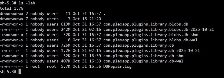

Been using plex for years without major issues, but recently made some upgrades and during the process I decided against spending few days moving few million metadata folders (in hindsight, terrible decision), I wiped it and started up a new plex instance and let it create a fresh db without a ton of bloat I’ve gathered over the years.
for ref, state of plex appdata from a recent check i did
now I’ve got a fairly large library but it does seem a bit crazy. but lets ignore that, gone, poof, deleted. and no I dont back this up, trying to zip 4.5mil folders isnt going to end well.

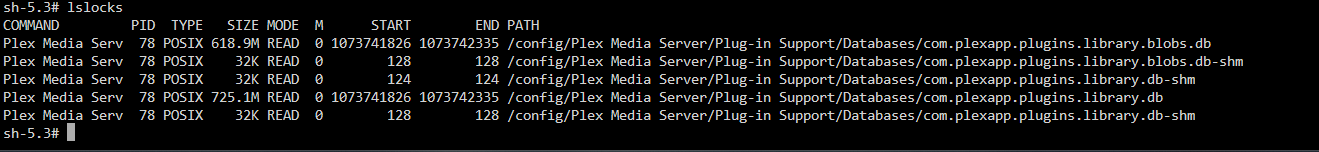

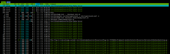

I’ve got it all setup, with minimal metadata handling. however when it came time for nightly scheduled tasks it’d always hang and I had to restart it to get it back up and working. eventually pinned it down to database optimizations, as I understand plex takes db offline to do these, which makes sense, however it just kept going when left, had it left for 3 days at one point, currently I have it at over a day, this is after dbrepair.sh auto.
Enabled logs, however all services seem to just be halted aside from whatever its doing in background and not logging it. For a test I’ve tried killing the 5 relay processes it created at some point, those log fine btw, here’s a snip of the output,
db optimisation was issues around 17:14, with no logs to show for it. at 4:40am it somehow picked up some network int resets (another issue entirely, likely down to container running in host on my unraid rather than bridge)

htop inside container, just 3 processes at constant 100% cpu (minimal system impact but they’re doing something)
looking at lsocks just shows them keeping databases open.

For the DB directory listing, please use ls -lah ( human flag)
It looks like a 10GB DB and 1GB blobs. This correct ?

for db, yes 1gb ish main, it has 1.43 backup in there, that can be ignored.
