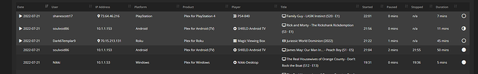

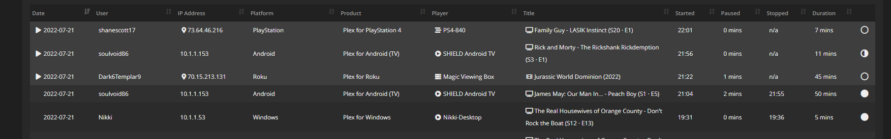

This was right around the time the server became unavailable. I run Tautulli and the server stopped reporting to it at 19:36, while you can see that it continued to play sessions that were already in progress. I noticed this at 21:04 and restarted the server. It came back up immediately as usual. (I also want to point out again that I run Plex with NSSM. I know this is non-standard.)
Again this didn’t start happening until a few months back, when there was a major update to the way databases are optimized. It’s fairly rare that it happens (2-4 times per month), and I had hoped it was just a release issue and would be fixed.
Screenshot of Tautulli server history

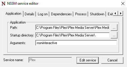

You might want to use the command line parameter -noninteractive when starting PMS. It suppresses all errors which have to do with the regular task tray icon on Windows. (which is not used when running as a system service)
grafik

Thank you for the info on running Plex as noninteractive. Appreciate making my logs easier to read :slight_smile:
