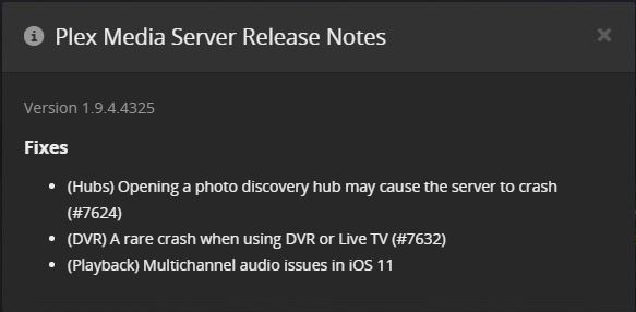

Still a problem on 1.9.4.4325
Given this was all that was contained in the update, I wasn’t optimistic that things would be working.
