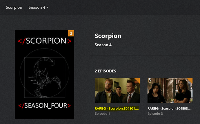

Running PMS Version 1.9.4.4325 on Windows Server 2016 guest on Hyper-V Server 2016 (core). 4 cores, 8G RAM. 80G C: drive, 50G volume for Plex, Sonarr/Radarr, & SABnzbd, 6.5T volume for Media. I’ve been running Plex for about 3 years, and have encountered something this week that I don’t understand.
I can’t explain the title (left one highlighted) - the file name/folder structure is the same as other media, and ffprobe shows the “title” metadata parameter matches the episode title, and no other file metadata shows this “RARBG” title.
I have backed up the files, deleted them from Plex, put them back, and after re-scanning they show the same odd name. The episodes in other shows/seasons are mostly normal, but I have maybe a dozen episodes that started showing up like this in the past 2-3 days.

Rarbg is a torrent release group
Might that be the reason ?
Go to Settings - Server - Agents - Shows - TheTVDB
In there, grab the line ‘Local Media Assets’ with your mouse and drag it downwards, so it ends up being at the bottom of the stack of active agents.
Repeat the same under
Settings - Server - Agents - Shows - TheMovieDatabase
Settings - Server - Agents - Movies - Plex Movie
Settings - Server - Agents - Movies - TheMovieDatabase
Afterwards, Refresh Metadata for the whole series.

@OttoKerner - Thanks - that worked flawlessly! I had only done that for “Personal Media Shows” but not TheDVDB or The Movie Database. I generally understand how the agents and sequencing work, but can’t figure out where it got the RARBG reference, especially for a handful of episodes that were originally titled correctly. I did do some maintenance this weekend - using Sonarr to scan and rename files, then ran my script to update the file “title” metadata. I’m guessing that this work triggered a metadata rescan during maintenance?

Absolutely - they haul out their junk and scent mark all their stuff by spraying urine Brand all over MP4/M4V files embedded in the Title Field where Plex’s Default Location of Local Media Assets (right on top - with tip-top priority) prefers that embedded title over a perfectly named file - detonating a high yield thermonuclear device destroying a match, and/or causing the exact problem shown above.
Otto’s solution is the ONLY solution for that particular beating Plex has no interest in doing anything about - so we tell hapless users how to fix it 100 TIMES A DAY!
What metadata does your script update?
The issue you’ve been experiencing is a clear sign that these files have nonsense in their ‘title’ meta tags.
@JuiceWSA - tell us how you really feel! :smiley: I do feel the frustration, and it’s one of the reasons I wrote my file grooming app. What prompted my question is that the RARBG title was being displayed even when it wasn’t present in the local media properties. Looking at Windows file properties, the title matched the episode and the comment was blank (yeah, I’ve seen a weird title come from the Comment field even when the Title property was correct - really??) I ran ffprobe to dump the attributes and saw the same results, then I ran a script I wrote that dumps ALL the extended attributes and again found no evidence of this title.
@OttoKerner - The grooming script runs nightly to import (does name processing, resizing, format conversion, and titling) new media from a staging area, then scans each library to either resize (where deemed necessary - select TV shows), convert the format, or update the title when it doesn’t match the file name. This last part is done daily because Sonarr might rename the files to properly match the episode, as my script will use a generic “Episode ##” when it isn’t provided in or can’t be deciphered from the original file name during import.
The “Title” part of the script gets the movie title or episode title from the filename part (ignoring the “series - s##e## -” part of TV shows and any qualifiers like 1080p, BluRay, 6CH, etc.). It then uses ffmpeg to set the “title” attribute to the extracted title, and clears the “comment” property. The whole point of this is to be able to programmatically manage my media (this started many years ago with MP3 grooming). This program is on its 4th major revision and has been used for a couple of years as individual scripts. I combined them into a single program with a common config file this past January. Never had an issue like this before. I checked the logs from when these files were updated and it showed the proper title being updated, which ffprobe verified on the file itself.
So I assume it the RARBG was part of the file name, which was then written into the ‘title’ metadata field.
Which in my opinion is the wrong thing to do. The ‘title’ of the movie/episode is not RARBG - scorpion...
If you want to store some ‘release group’ info, you should better utilize the ‘comment’ field.

@OttoKerner - My software specifically looks for words in the title and removes them, RARBG is one of them. So - even if it had been part of the file name, when my script runs, it figures out the series, season/episode, and title, removing all other parts of the title - and it does this before setting the internal title metadata. I even have control over ignoring files based on the name or name part, so “RARBG.COM.MKV” isn’t even processed. I even go so far as to remove the fake “subtitles” when media is onboarded.

Sometimes that stuff is stuck inside the metadata of the file itself… yay. I use AtomicParsley to purge it.
atomicparsley ‘path to file’ --metaEnema --overWrite

Do you have the .nfo importer agents installed? These could theoretically use the episode title from a Kodi-compatible .nfo XML file.
