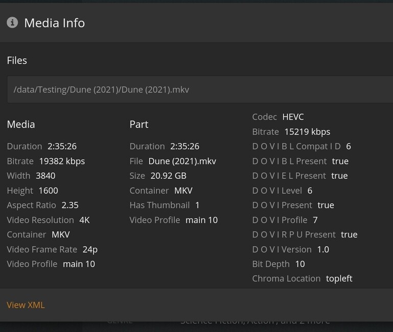

Here is an example file details that I’m having stuttering while transcoding, fairly high bitrate. Transcoding down to 1080 SDR
Are you able to check your radeontop to see what kind of GPU utilisation you’re seeing while it’s transcoding? I’m not seeing more than like 12% utilisation of GPU while it’s stuttering around.

My copy of Dune is not as high as a bitrate as yours, but I am transcoding nonetheless and it plays very smooth:
Maybe that’s what it is. The 4K files I have been using for testing have all been high bitrate, 20mbps+
