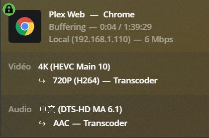

So when I transcode something I’m expecting to see some hardware acceleration but it appears not:

Sep 14, 2019 12:58:09.329 [0x7f1e997fa700] ERROR - [FFMPEG] - Cannot init CUDA
Sep 14, 2019 12:58:09.329 [0x7f1e997fa700] WARN - avcodec_open2 returned -1313558101 for encoder 'h264_nvenc'
Sep 14, 2019 12:58:09.329 [0x7f1e997fa700] ERROR - [FFMPEG] - No VA display found for device: /dev/dri/renderD128.
