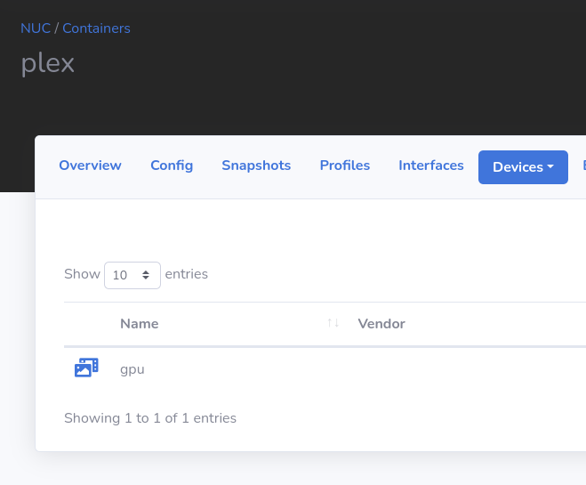

The quintessential thing you must do is guarantee the full passthrough.
I’ve seen a lot of folks get tripped up with the new ProxMox and, unfortunately, there’s nothing I can do about it.
FWIW: I have QuickSyncVideo in a regular LXC on Ubuntu working without issue.
  1. Create the GPU with the proper GID for access inside the container
  2. Ensure udev sets up correctly on the host.
Screenshot from 2023-07-14 11-15-22
I know how I added it using lxc config commands. I’ll share what I can.
