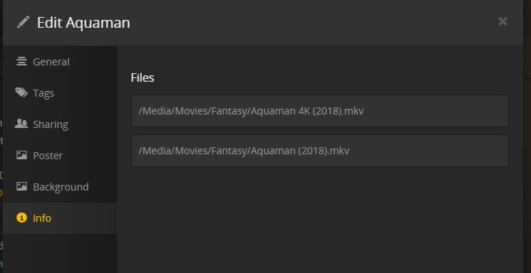

So I have a couple movies with both 4K and 1080p rips done (one with 4K in the file name). When I put them both on Plex they show up under the same movie banner. How do you pick which file to watch, or how do you force it to separate them?
Well it appears Plex is smart enough to know which to use… 4K plays to living room. 2K transcodes to phone.
