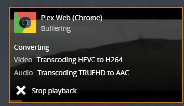

I’ve tried both HEVC and x264 content…neither will show the “hw” next to it, and cpu usage is through the roof with only 4 cores.
I made sure that “Use Hardware trans-coding where available” is checked, made sure the processor matched, etc.
Am I missing something here? The 1225 v5 should support it, The OS supports it, so why isn’t it working? One last bit, I’m a plex pass subscriber so that’s in place.

Thanks man. Not sure if you remember our chat re: HBR, but I broke down and bought a Nvidia Shield, ditching the NUC 7i3bnk on Ebay, shield does everything, 4k, HBR,HDR, and it seems faster too…if only I could figure out how to boot it into plex.
Re: the Dell, I think I’ll end up doing one of two things. I monitor it in both graphana and librenms, if I see CPU load staying too high, I’ll either swap out the 4c/4t E3-1225 for a 4c/8t E3-1270, or ebay that and get a R430 with a E5-2620v4 (8c/16t) or E5-2630v4 (10c/20t) cpu… I would consider supermicro but I can usually get the Dell’s a lot cheaper…my storage is Supermicro based though…
@ChuckPA said:
Be advised, if you put a GPU card in, making it the primary display driver and accessible to libva is entirely on you. At present, stand-among GPU cards (nNidia / AMD) aren’t supported for hardware transcoding.
Any idea when this would happen? I see it looks like an nvidia shield can do trans-coding, an nvidia AIC can’t?
Edit: disregard, misread the shield…it just decodes, does not encode.
I don’t know either product, sorry.
Of course I remember the conversation @evanrich. I keep track of all my high end peer users trying to setup the ultimate playback experience.
Pardon the bump and my first post. I debated bumping this old thread vs starting a new but somewhat duplicate topic.
However, I believe I have been burned by this issue. I purchased a Dell T130 Power Edge Server in 2017 mainly to be a ZFS / Samba File server. My Celeron G3930 which is nothing fancy but was perfectly suited for serving files does have QuickSync in the processor.
I have been unable to get Plex to HW transcode any video content. I do see a device at: /dev/dri/card0,
sgrey@endurance:~$ ls -la /dev/dri
total 0
drwxr-xr-x  3 root root      80 Sep 15 09:43 .
drwxr-xr-x 18 root root    3560 Sep 15 09:43 ..
drwxr-xr-x  2 root root      60 Sep 15 09:43 by-path
crw-rw----  1 root video 226, 0 Sep 15 09:43 card0
but lspci shows
07:00.0 VGA compatible controller: Matrox Electronics Systems Ltd. G200eR2 (rev 01) (prog-if 00 [VGA controller])
I was just looking for a confirmation that my suspicions are correct that the internal Intel video adapter is disabled. Thanks to those above who went to the lengths to get an answer from Dell.
Has anyone found a work around? I looked at buying a Nvidia Quatro P2000 but I don’t have the power supply to drive that kind of card. I have also considered getting a Xeon just to brute force CPU transcode. My needs are limited I only need to be able serve up 2-3 streams simultaneously. I was also considering pre-optimizing my content. I am just serving content to a few Apple TVs and an Ipad. The content is LiveTV in MPEG2 format from a HD HomeRun Quatro.
Thanks in advance
For Plex Hardware Transcoding to work right with Intel QSV,
/dev/dri/renderD128
must exist and point to the QSV device.
nVidia uses a different mechanism. If their drivers are loaded, the transcoder will attempt to use it through their driver.
I did find an alternative solution.
It would appear the Plex app for Samsung TVs can decode mpeg2 with hardware acceleration. Therefore the content doesn’t require my server with limited resources to transcode to h.264.
