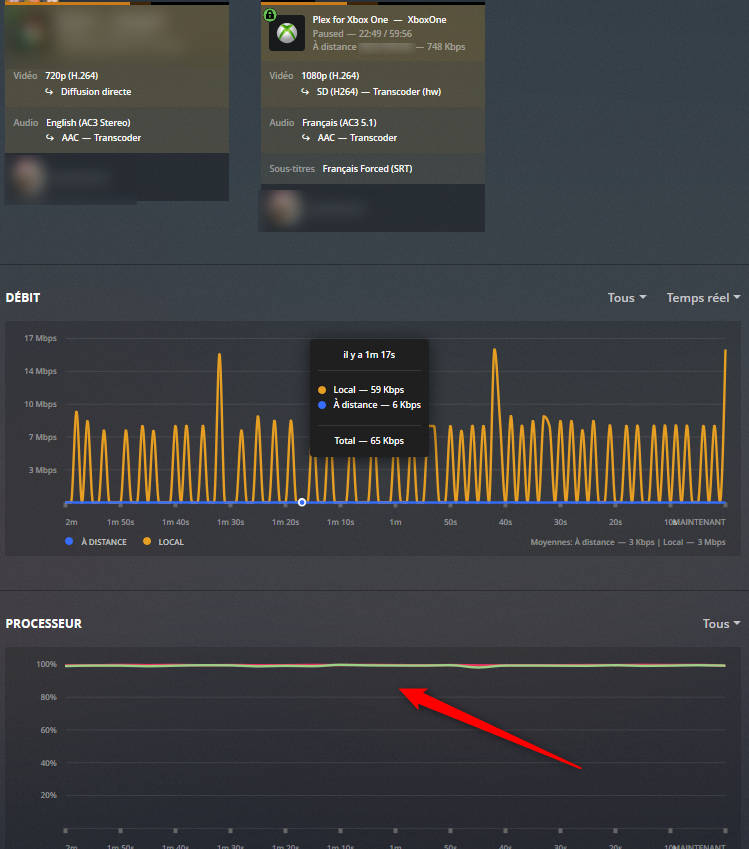

So, the problem is that when i remotly play a video on my XBOX ONE from my media server (Microserver Gen 8, Intel(R) Xeon(R) CPU E31230 @ 3.20GHz, NVIDIA GTX1050, 8g RAM, UBUNTU Server 18.04) and set the quality to SD (480p), because of my internet speed, the server seems to (mostly but not everytime) encode via CPU and not from GPU, despite what the dashboard says.

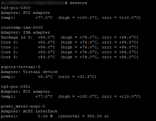

My server runs the fan up to it’s maximum speed and it’s very noisy !
I already installed the nvidia codec patch (here) and the nvidia drivers patch for more than 2 simultaneous encoding.

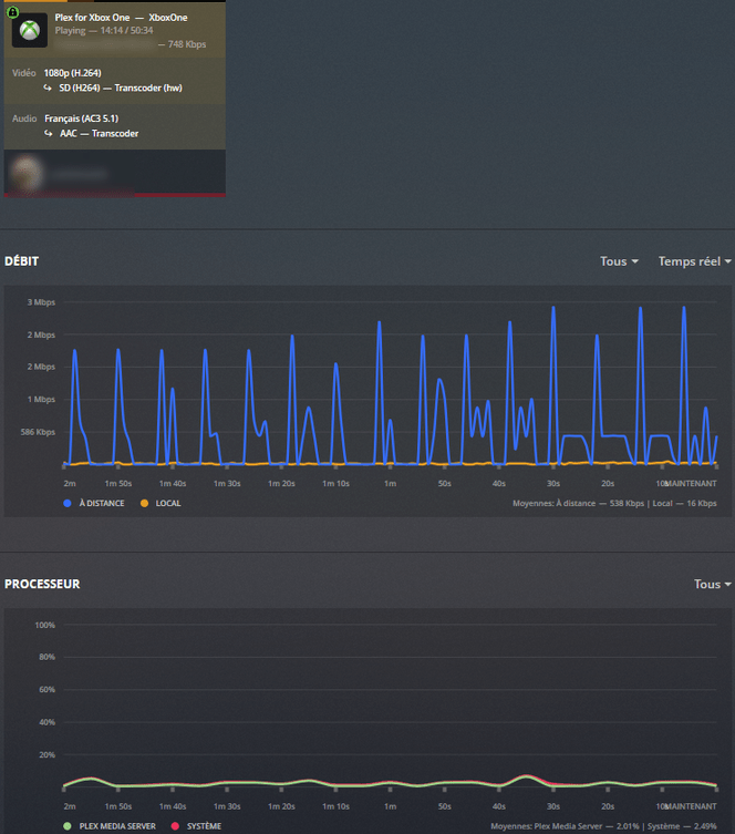

I don’t know why but sometimes the hardware mode seems to work correctly?!
If i pause the video and start again, sometimes, not everytime, it switch to TRUE hardware mode… I seted Transcoder default throttle buffer to 120sec but it does not change anything.
To finish, in all others conditions (playing on chromecast, on tv, transcode 4k to 1080p, 1080p to 720p or 480p) the hardware mode run smoothly.
Thank you for helping !
It looks like only your encode is being done by the GPU. The decode of the original movie is being done by the CPU as indicated by this image:
2019-05-19_10h51_43
You can see the (hw) indicator next to “SD (H264) - Transcoder” but NOT next to the decode “1080p (H.264)” directly above it. This is what might be using the CPU and possibly a driver issue or an incompatible source media format causing it.
