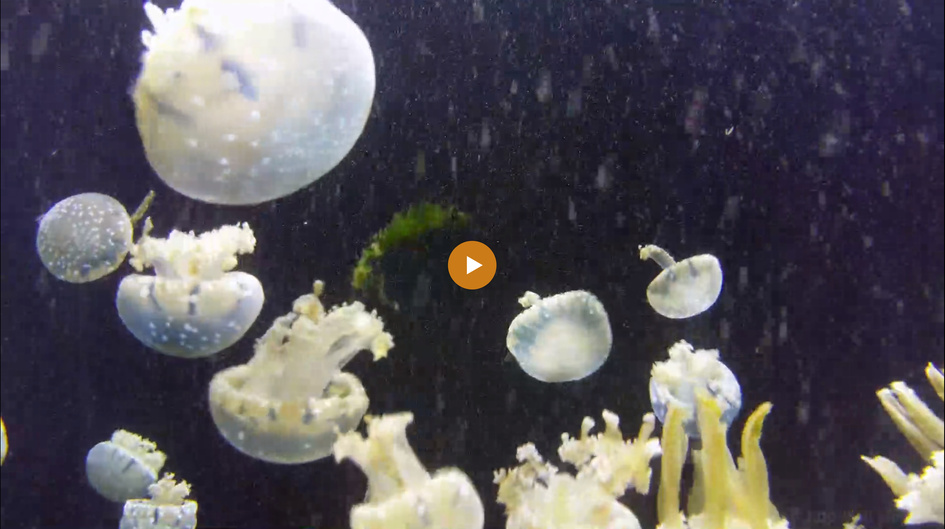

(jellyfish-20-mbps-hd-hevc.mkv)
viewed hw encoded, the 20 mbps sample is significantly worse than the sw encoded.
hw
sw
This is severe quality drop.

I am hoping that folks with Intel haswell CPU’s + SQV working will grab these samples, and try it for themselves, let me know if they see it as well.
Heck, I would gladly invite anyone who is interested in seeing it for themselves to see it off of mine. it might take some coordination, try opening it a few times etc. but as soon as Plex uses hw encoding on that 20 Mbps sample, the quality is terrible.
It does not just happen on that sample of course, but I finally found a publicly hosted royalty free clip that triggers the issue! now I just need some fellow testers interested in hardware trans-coding in Plex :slightly_smiling_face:

To you second point. the hw-encode quality (I believe its the encode that is the problem, not the decode) from the 3/5/10/15/25 mbps jellyfish samples is MUCH better the 20 mbps sample. I suspect this would indicate it is not the hardware.
I care because, on a few files, the quality is horrible. most are just a bit worse, but more than acceptable. I am OK with a small degradation, this is expected. I am worried about the odd file, or the odd piece of some files, that it is just terrible. It’s not random, I can reproduce it, so hopefully, this can lead to a solution!

I build another test server, this time with 1.1.4 the public PMS server. windows 10 e3-1275v3 QSV etc.
the same issue. the 20 meg sample, when it decides to use QSV, it is blocky as heck
I did notice one additional item!
It looks terrible when it is set to “convert to 1080 HD (High) (Maximum.) 19.9 Mbps.”
It looks just fine when I select “convert to 1080p HD (medium) 12 Mbps” or “convert to 1080p HD 10 Mbps” or “convert to 1080p HD 8 Mbps”

Thank for looking. I am at a bit of a loss. can you look at my screen shots, do they look similar to you? I am not sure if I am been too picky but its night and day to me. were you using the web client?
