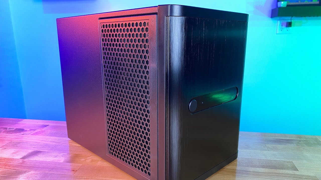

NAS are very expensive in comparisson when you look at the hardware inside. Building your own Plex server and then getting a solid operating system like Unraid for it will get you much more performance for the same/less money. A NAS is of course more convenient in many ways. It all depends. But getting an expensive NAS mostly for Plex is a waste of money in my eyes.
As an example, look at what he built here:
