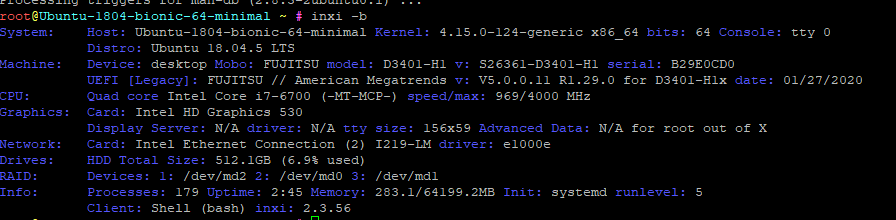

Hello
I am running an Ubuntu 18.04 Plex server on a i7-6700. This config has an onboard intel HD Graphics 530 gpu.
I have hardware transcoding turned on, however i get CUDA errors in the logs and no (hw) text in the details of a playing video being transcoded.
Im at a complete loss…any help would be great.
EDIT: Additionally running ls -la /dev/dri gived ls: cannot access ‘/dev/dri’: No such file or directory so i do think something is wrong.
EDIT 2: Sorry i should have been clearer…my goal is to have HW transcoding working and using the onboard Intel 530 GPU. I don’t believe this is working.

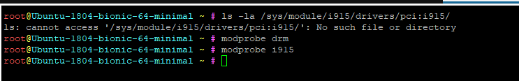

This will confirm if the i915 is found by the kernel.
If it is:
  1. /dev/dri will be created by the kernel
  2. PMS will also respond to both /dev/dri/renderD128 at that point.
[chuck@lizum debian.544]$ ls -la /sys/module/i915/drivers/pci:i915/
total 0
drwxr-xr-x  2 root root    0 Nov 21 01:49 ./
drwxr-xr-x 39 root root    0 Nov 21 01:49 ../
lrwxrwxrwx  1 root root    0 Nov 21 22:06 0000:00:02.0 -> ../../../../devices/pci0000:00/0000:00:02.0/
--w-------  1 root root 4096 Nov 21 22:06 bind
lrwxrwxrwx  1 root root    0 Nov 21 22:06 module -> ../../../../module/i915/
--w-------  1 root root 4096 Nov 21 22:06 new_id
--w-------  1 root root 4096 Nov 21 22:06 remove_id
--w-------  1 root root 4096 Nov 21 01:49 uevent
--w-------  1 root root 4096 Nov 21 22:06 unbind
[chuck@lizum debian.545]$
Observe the i915 has a PCI address.
I was actually going to suggest something similar. Since /dev/dri/ is populated by the drm module, try the following:
modprobe drm
And:
modprobe i915

Ok, none of those commands return anything, see attached.
Yep, its console only.
EDIT: I guess untill i can get the gpu “claimed” then none of these will do anything. Is it s driver issue?
I should have been more specific; the two modprobe commands shouldn’t return anything. They are loading the kernel modules which provide direct rendering and provide the driver interface. Check /dev/dri/ now to see if exists and is populated. Also, run vainfo now to see if it reports anything.
For what it’s worth, everything will probably “just work” if you install the desktop version of Ubuntu. The desktop features pull in all the required drivers by default and load everything at boot. However, as far as I know, these are the packages you must have for this to work:
  • libva2
  • i965-va-driver -or- intel-media-va-driver
  • vainfo (optional)
And, of course, the kernel modules.
Is this a “Server” distro which is loaded?
If so, none of these drivers will be installed by default.
For Plex use, Workstation is always best. You can turn of the GUI after install.
Yes this is the server distro.
Still getting -bash: cd: /dev/dri: No such file or directory
Ive checked and all those packages are installed. vainfo gives:
error: can’t connect to X server!
error: failed to initialize display
Which kernel modules are needed.
That’s a huge list to write. It’s really outside the scope of the support I can provide given the OS distro does it automatically.
