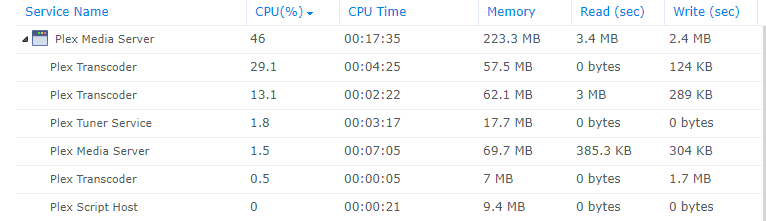

I thought perhaps “it just can’t transcode that” as well, but I thought since non hardware assisted was better than HW perhaps there was something else wrong. The CPU usage seems to indicate some headroom:
(1080i Transcode going on, as well as audio and video playback to two other screens)
And nothing else slows down during transcoding so it seemed odd.
That said, I don’t know that PMS officially endorses HW accel on NAS devices, even when equipped with a CPU that supports it so I may be chasing a problem I can’t solve outside of investing in the Home Run Extend, which I am willing to do if it will solve my problems.

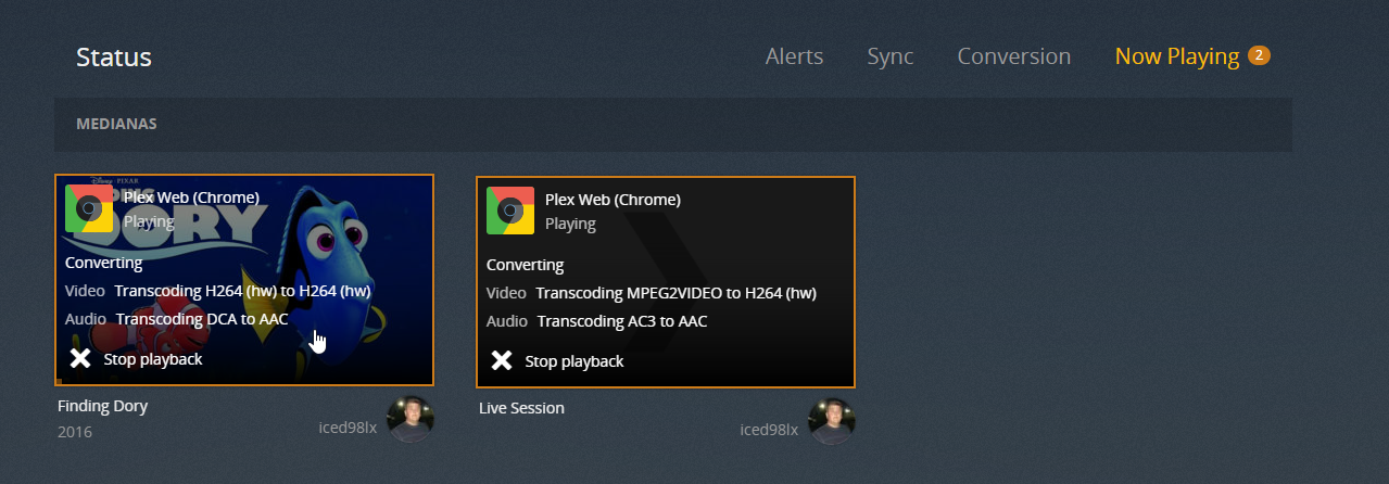

For S&G’s I left the TV playing, and set my favorite test case Finding Dory to transcode from source 1080p to 720p 2mbps at the same time on a different machine: (I combined two screen shots to show both transcoding):
The TV Played normally except when occasionally dropping out to what looks like buffer, while the movie played without hiccup and the CPU usage is as such:
So it’s either the mpg2 transcoding portion or my HD Home Run is having a problem? I opened the same channel on the HD Home Run app and let it play for 10-15 minutes and it didn’t hiccup but that of course only suggests the mpeg2 stream is coming through ok.
