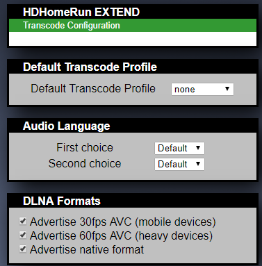

Edit: Adding screenshot of the Extend Transcode settings showing it is set to none so Plex is setting the transcode during Live TV streaming using the Extend.
SiliconDust informed me that plex ignores these settings (although I tested it just to make sure). They tell me that the relevant settings to choose are within the Plex app
No matter what settings I put on the HD Homerun settings from the screenshots you show or from the plex app in the screenshot I show, the plex performs the same. I set a daily recording of PBS news hour to test my recordings from the HD Homerun CONNECT vs the EXTEND during my transition and while altering all the settings. The only thing that has changed is MPEG2 vs H264, however, SiliconDust informs me that this H264 conversion is not from their hardware as the inspection of the TS file indicates it was converted using ffmpeg, which they said is the fault of plex. When I set the setting all the way down to 240p every recording is still in broadcast resolution (1080p or 720p) and still converted to H264 using ffmpeg, still the same file size, etc.

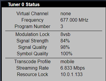

@johndavies24 SD is partly correct in that Plex does use ffmpeg from what I understand as part of the process to remux the individual 1 second recordings it creates in the transcode folder into a single ts file. The internal video coming from the Extend should still be h264 or mpeg4 though, just wrapped in a ts container. As shown in my prior screenshots and confirmed by @leguelp Plex does send the transcode setting to the Extend when it requests a recording or Live TV session. Here is a log entry from my Extend starting a recording, notice the ?transcode=mobile included at the end of the URL for the recording. That is how Plex is sending the request to the Extend to use a specific transcoding profile.
Oct 12, 2017 22:03:12.655 [0x70000d03e000] DEBUG - DVR:Recorder: It took 1.4 sec to start the session for http://10.0.1.20:5004/auto/v63.1?transcode=mobile
