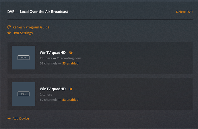

  1. Just setup my Hauppauge quad tuner card and it only sees 2 tuners… curious if it is supposed to see all 4?

Dummy me didn’t notice the 2 tuners say 2 on them each… hah…
got a new antenna and did a rescan on BOTH… and got different results…
not sure why it picked up different channels… and why does it not enable them all? is it based on it detected the channel but not watchable?
