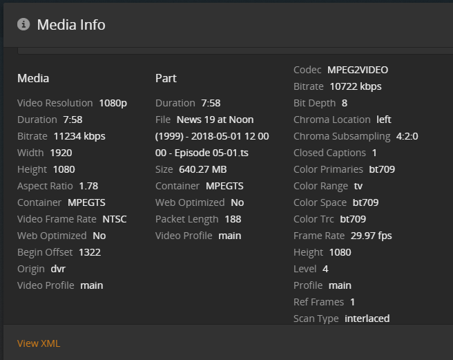

No it does not transcode to mp4. Setup a test recording of the last 12 minutes of a local news show on one of my servers and turned on the commercial removal.
As you can see the video codec is mpeg2video
hmmm, thanks for the info, that’s too bad, it would be a nice option to add
There is the experimental transcode option for a tuner device that will transcode after the recording is complete. But be aware that on lower powered servers you may find shows that seem to never finish recording because the server does not have the processing power to be transcoding one or more shows while still recording others.

The Extend has its own transcoder settings that determine the h264 encoding that is done by the Extend before sending to plex. The Quattro will have Settings like shown in my image above.
