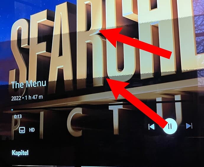

The overlay bug I described here =>
It’s fixed with Windows 11 24H2 and the latest Nvidia driver. It is also fixed in Chromium-based browsers.
I also found a “fix” on older Windows versions (10 22H2 / 11 23H2). It’s fixed by adding --disable_direct_composition or --disable_direct_composition_video_overlays=1 (either of those does the trick) to the Chrome shortcut or the chrome.exe. (Can be checked under chrome://gpu and the “Command Line”)
