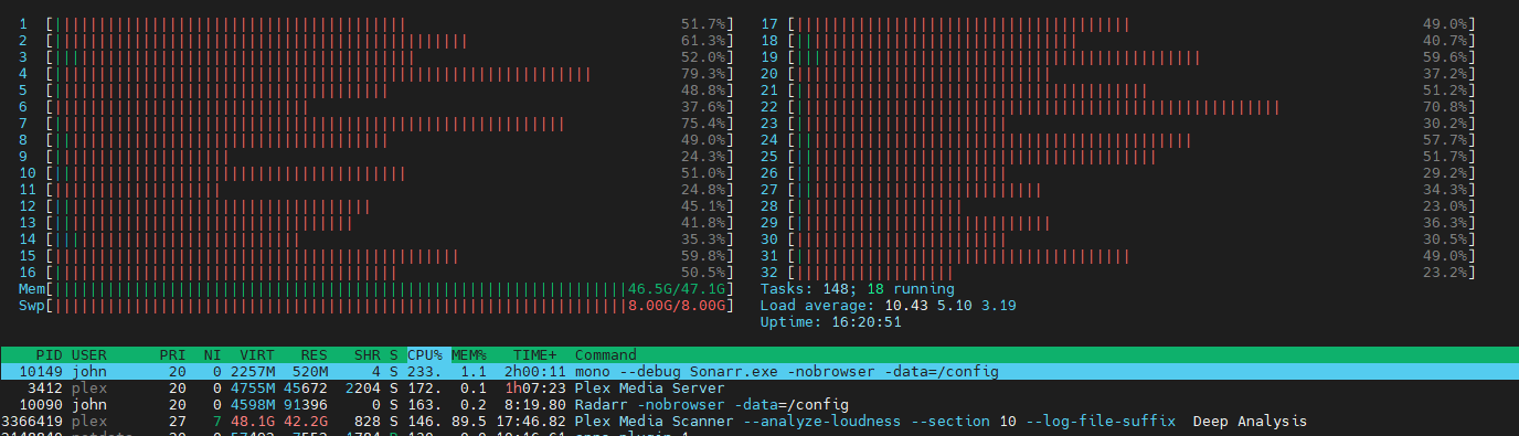

  2. When this happens, it uses my entire RAM and then takes down my server completely. For that reason, it’s been tough to troubleshoot even this far, but setting “Analyze audio tracks for loudness” in Library to “Never” stopped it for a week.

(BTW, if you look at the htop screenshot in the previous thread - yeah, I’m pretty sure where the issue lies!)
