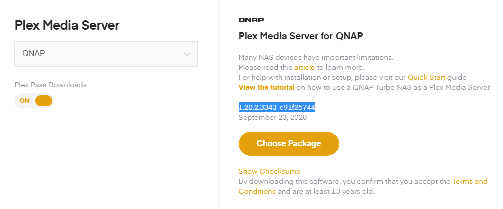

I can only see 1.20.2 in the downloads publicly…
See the Plex Pass Downloads button?
Turn it OFF
I just noticed that and I can get the August 27th version. Thanks! I’ll try it out and see if anything improves.
