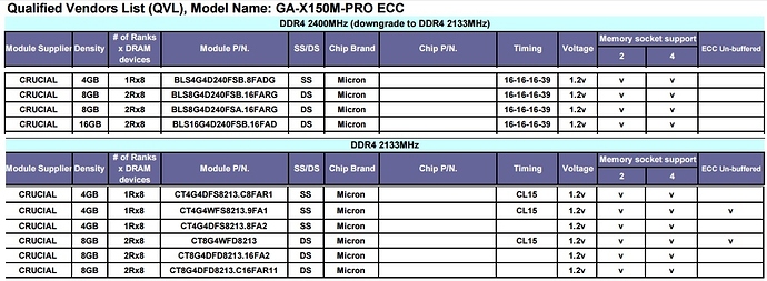

Looked up memory compatibility, Crucial sais it is compatible on their website, but Gigabyte does not list it under compatible memory. It should be good enough when Crucial sais it is ok?
Took a screenshot of the compatibility list at the Gigabyte website and the check on the Crucial website for the memory I chose above
Link to the list
Crucial 16GB Kit (2 x 8GB) DDR4 2400 ECC UDIMM
I would buy the Crucial memory. Gigabyte only checks a handful of modules so I am not surprised that yours are not on the list.
