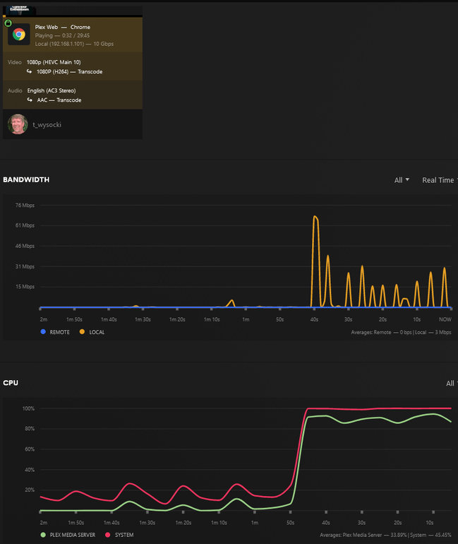

There’s a huge problem with stuttering and performance on some TV shows from Sonarr. But I think I found the issue. I’ve watched the dashboard and there’s a ton of cpu used for shows with codec HEVC versus very little for codec H264.
Why is HEVC so cpu intensive, how can I prevent it, and is there a setting in Sonarr that I should be using?

Sorry, I had bad info. The server is actually an i5 (NUC5i5RYB), version H40999-504, and I can’t find that model isn’t even listed on Intel’s site! I was showing the run from a app.plex.tv on Chrome from a workstation. Direct Play and Direct Stream were enabled.

That NUC has an i5-5250U or i5-5257U CPU.
The QuickSync graphics (embedded GPU) in 5th gen Intel CPUs does not support decoding of HEVC video. It does support decoding of H.264/AVC, MPEG2, & VC1 video.
Therefore, when transcoding HEVC video, Plex will use the CPU to decode the video.
That is why the CPU hits 100% when transcoding HEVC video but only 10% when transcoding H.264 video.
Ok, but why is it transcoding the H264 now? That show downloaded on 12/08, three days before I played it, and it still is doing transcoding & buffering now. How long should it take to do this deep analysis and how can I tell if it’s been done?
Is my only solution to buy a new NUC? Interestingly, playing the file on Windows 10 browsers shows it in Direct Play. Why not on the Roku?
