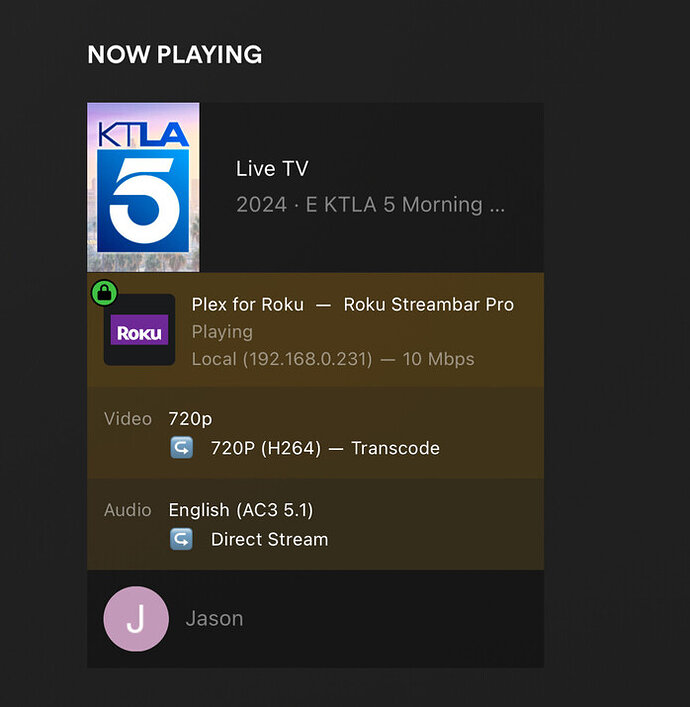

I had to disable HEVC last night because a family member was getting a blank screen with audio only on a XBOX One.
So this morning I went to watch Live TV with HEVC still disabled and at first it struggled to start playback but then figured it out. After a couple of minutes this happened.
No hardware was being used. All software transcoding.
