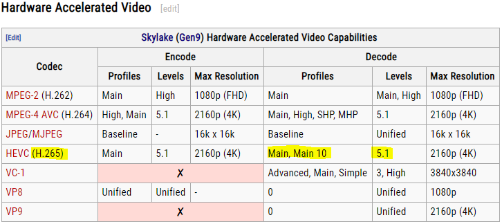

I’ve posted a couple of other threads about hardware transcoding issues using a Skylake I5 CPU with very little response except to say that HEVC Main-10 Decoding is not supported on Gen-6 Intel CPU’s which I need to challenge.
Firstly, because I have had the same problem with EMBY on the same hardware and after logging a support ticket, they identified the issue and have since corrected it. EMBY is now transcoding all my HEVC Main-10 content perfectly.
Secondly, I’ve found technical articles and support sites that suggest support was added in newer drivers and is indeed capable of HEVC Main-10 transcoding. See here: HD Graphics 520 - Intel - WikiChip
Thirdly, using PLEX, a large percentage of my HEVC Main-10 content does transcode correctly without issue. Just not all of it. Surely, if it was simply not capable, it just wouldn’t work? I’ve established the content is not the problem as it works just fine on EMBY using the same hardware, and on PLEX using newer hardware.
