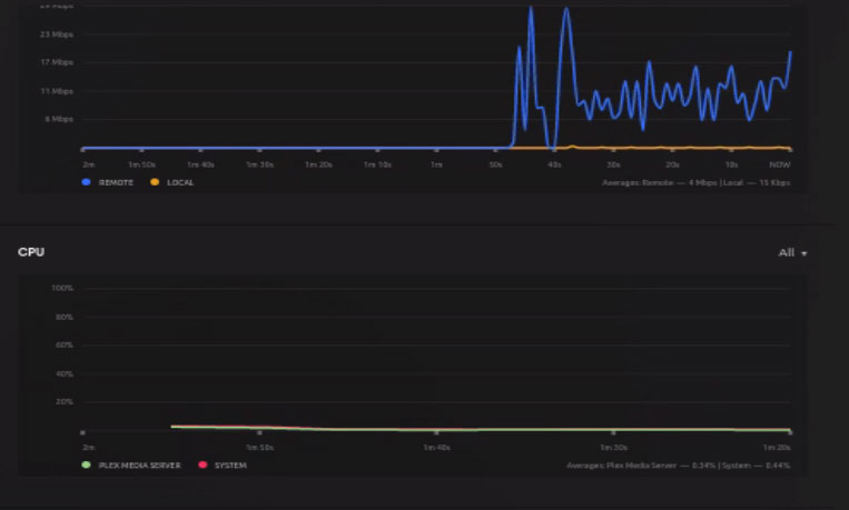

It has been about 45 minutes since I last restarted PMS and disabled the detect credits on the rogue library. CPU usage is currently sitting at 38% with 7 remote streams (all Direct Play, zero transcoding)
Plex Media Server Logs_2023-03-11_16-51-01.zip (6.4 MB)
I’m seeing several playbacks and transcodes. If 38% in the Plex report then that’s not bad for what I’m seeing of all the activity.
The CPU is handling the audio transcodes and remuxes well. Very nice.
Is anything objectionable to you ?
Prior to 6 months ago when the high CPU usage started, I never saw it go above 20% and was typically under 10%.
Right now I have 7 streams (6 remote, 1 local) all Direct Play and still sitting at about 38%. Maybe I’m overreacting … just seems strange that for 2 years CPU usage was minimal but now it’s not. When it gets above 75% is when videos no longer play. So far, disabling the detect credits in the rogue library seems to be a help.
I typically see DirectPlay at about 3-4% on my CPUs.
Using that metric, It’s reasonable to be about 21% CPU

Going on 1 hour since blocking of IP and restarting PMS and it’s still sitting at sub-10% CPU usage. Thank you!
