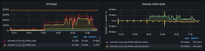

I noticed high CPU and bandwidth usage from my Plex server while no media was being played. Attached log shows rapid transcoder errors related to AAC decoding. The CPU usage and errors return after restarting the Plex service.
Ubuntu 20.04.2 LTS
Any ideas? I’ve been digging through the logs but don’t see anything else out of the ordinary as of yet.
Thank you.
Edit: Added screenshot of prolonged CPU/bandwidth spike. Looking back through the historical graphs I can see that this has happened a few times over the last couple days.
