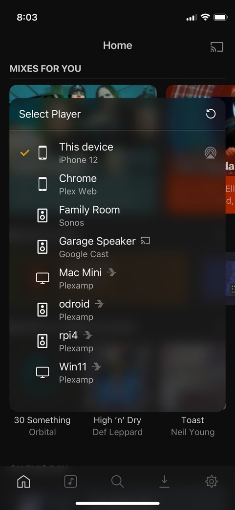

@fabien756 are you trying to change the word “Plexamp” that shows under the device name, like in the casting menu shown below?
The device name can be changed, but I think the text in the line below the device name is fixed, and refers to the specific protocol or app type being used
Yes, that is the case. The text below the player name is the application in this case. I’m aware of no way to change that.

“plexamp” is the client type and cannot be changed.
You can only change the client name.
Using the browser, hit ip:32500 and edit the player name in advanced settings. It’ll modify the device’s name.
