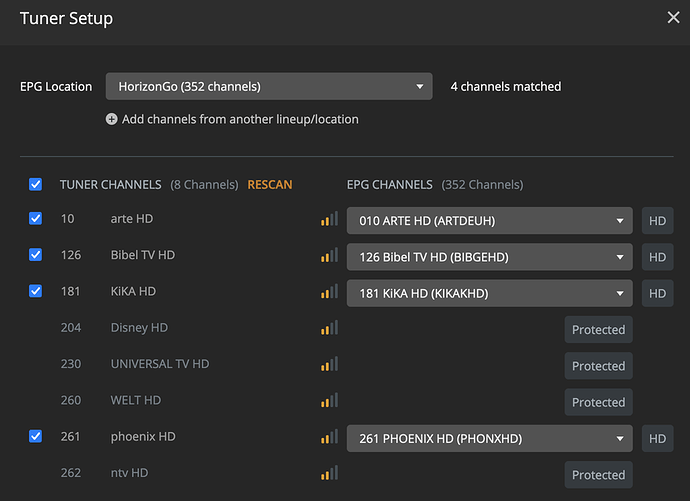

During the initial setup, I tried to guess the right entry for the Tuner Setup…
And selected a proper Network, as far as I could guess…
After that, the channel scan brought me just 4 usable channels (out of 186).
Grrr :frowning:
So I would like to try other ‘entries’ and restart this Tuner Setup - But how to?
Any Ideas?
