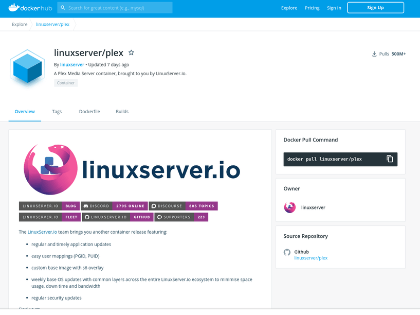

I thought I grabbed that line straight from their website sample. Can you please tell me what the image line should be?
I got it from here
linuxserver/plex - LinuxServer.io
You want the Linuxserver.io repository.
a simple google returns:
https://hub.docker.com/r/linuxserver/plex
At the link you provided, the recommended docker-compose file lists what I am using.
that’s not right.
Get the image, write the composition file yourself.

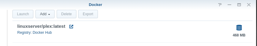

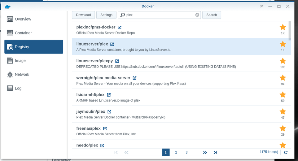

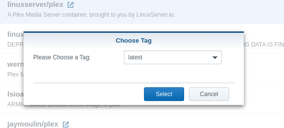

When I install:
Do you have this?

I didn’t use the native synology GUI because I couldn’t find a way to map the GPU device required for quicksync. I will try that option.
