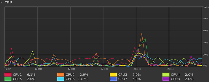

The CPU side of the transcoding really isn’t doing much to the CPU either. These are 8 vCPU’s from a 10850k passed through to a VM:
