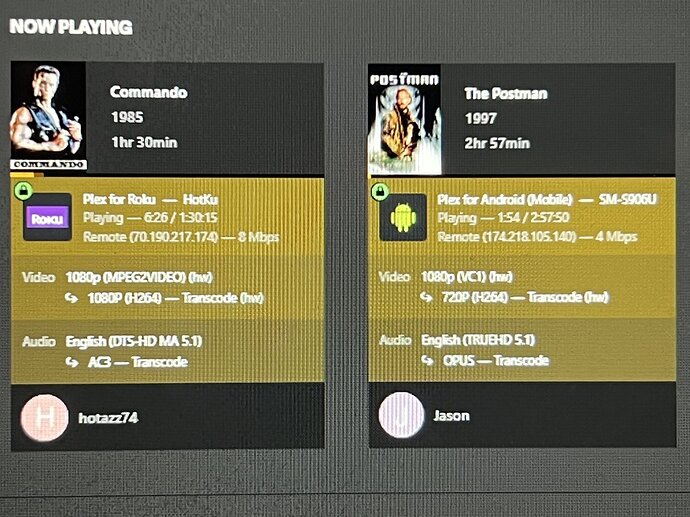

I have found an issue when using the UHD 770 and VC1. PMS chooses software to decode the source file and hardware to encode. But… It gets stuck at 33% and never starts playing.
As far as I can tell, the UHD 770 does support VC1 decoding. I do believe it will be the last video decoder from Intel that will from what I’ve read. I just switched back over to my A2 and all is good. I attached the log so you can see what happened.

@sa2000 and @chris_decker08 looks like todays beta has fixed the VC1 and MPEG2 decoding issues on the UHD 770. So as far as I can tell all is good!
