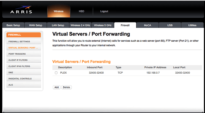

on my modem/router i have the ip address of the computer using the port for plex… No other devices on my network have the same IP… I’m at a loss…

and I just went back in to the modem/router and assigned a new ip address to the computer, then reported the 32400 - then used a fresh plex app downloaded, and does EXACTLY the same thing… Chevron flickers in menu then gone… Plex server will absolutely not run..

My point was not about some misconfiguration on your router.
According to the log snippet you had posted above, Plex fails to register and listen to the server port (32400) locally on that Mac.
