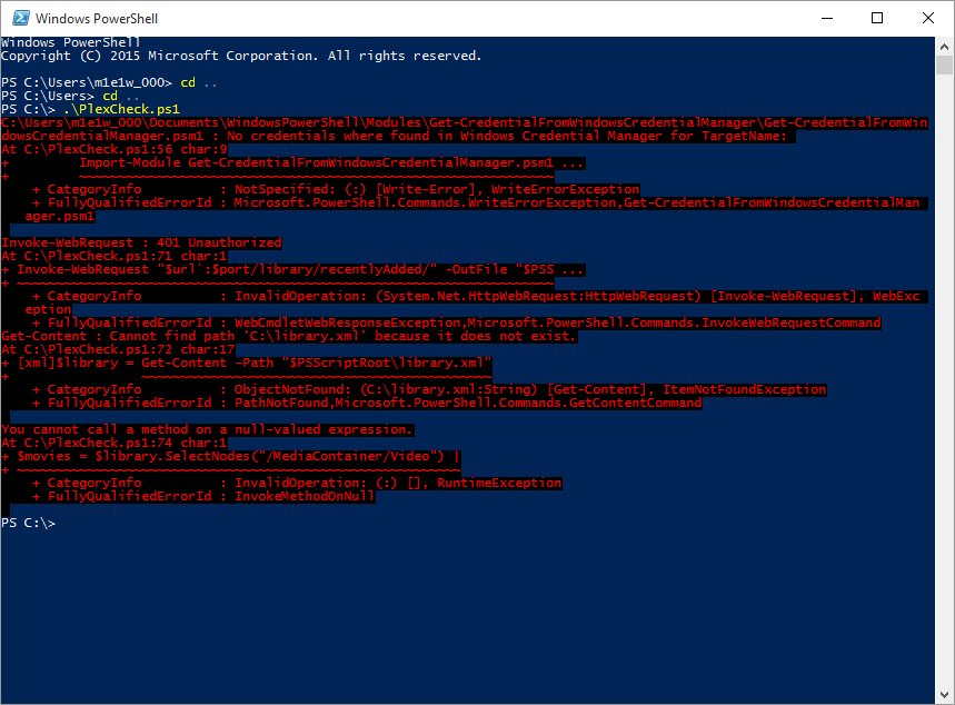

I managed to get most of the script working, but ran into a few issues.
Sometimes, when i run the PlexCheck.ps1 script (as administrator) i get:
~windowsCredentialManager.psm1 : No credentials where found in Windows Credential Manager for TargetName:
At C:\PlexCheck.ps1:56 char:9
when that does go through, i then and always get:
Invoke-WebRequest : 401 Unauthorized
At C:\PlexCheck.ps1:71 char:1
+Invoke=WebRequest “$url’:$port/library/recentlyAdded/”
so, i tested with how i have my file setup. for my plex location, i have localhost rather then 127.0.0.1 as its the same thing… but all my pages load as localhost with everything else.
i then wrote a full url string based on what the code calls for: localhost:32400/library/recentlyAdded/
and i get 401 Unauthorized.
is it an SSL issue? a plex user name issue?
what is the full command string you’re using? localhost instead of the IP shouldn’t be a problem. shouldn’t be a plex credentials issue either, since you don’t need those to make the API call.

the credentials (windows Credentials (generic) i entered; might be an issue? i entered Internet or network address as: PlexCheck, User name as the email address i want to send to (as a login?) and password of the email account.
running in WIN 10, powershell is running as admin, permission is set as unrestricted. only change in the code i made was the email address to send the report instead of test@test.com (default) i entered my gmail.
Other things to note:
my plex loads with the url http://localost:32400/web/index.html#
writing the url with http://localhost:32400/library/recintlyAdded/ = 401 unauthorized.
I believe my library is not stored on C:, but is stored on H:\Plex Media Server\plug-in Support\Databases\
@m1e1w1 so, the email address you should be putting in Credential Manager should be the From address. you don’t need to/shouldn’t alter the code to set the To address, just pass that as a parameter. same as the URL: if you don’t want to use the 127.0.0.1 IP (which should be totally fine with what you’ve said about your setup), you can also pass that in:
.\PlexCheck.ps1 -emailTo recipient@test.com -url localhost
try downloading the script again and using it as-is, passing in the values you want instead of modifying it. i’d also recommend running it from your Documents folder instead of root c:. if that still doesn’t work, try pointing your web browser (on the server itself) at 127.0.0.1:32400/library/RecentlyAdded and see if that returns the expected XML.
@sup3rmark
i just tried 127.0.0.1:32400/library/RecentlyAdded and localhost:32400/library/RecentlyAdded URL and i dont get an XML page. just 401 unauthorized. i will drop new scripts too, but i think i will need to resolve the 401 error before i even get data to email.
@sup3rmark
I corrected the credentials page, per instructions as well as new scripts.
@m1e1w1 the 401 is definitely something to do with your server, not the script… you might be using a different port or something. you’re running the script on the PMS, right? go to your plex server settings page, hit up the Remote Access tab, and tell me what it says next to Private.
feel free to hit me up on hangouts to discuss this more easily - [myusername]@gmail.com
sure. i started a conversation in hangouts.
@sup3rmark
after checking the thread you posted, it reviews if i have a pin enabled, and i do not. i did try and enable a pin, and then removed it, rebooted the PMS, still getting 401. I’ve also tried to see if the network subnet was an issue, and for the PMS machine, i was on the same subnet as my router. i do have a synology nas that has 2 subnet addresses, 1 matches the router and the other is a VPN’s subnet. i disabled the VPN, tested and that made no difference.
i checked my router just to be sure that port 32400 was open for any connection, and it is.
still have 401 unauthorized when using the url: localhost or 127.0.0.1 and :32400/library/recentlyAdded/ as the script requires.
@m1e1w1 unfortunately, i don’t know if i can help you with that issue. the problem you’re having is with your server, and is unrelated to the script. good luck!

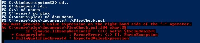

Sup3rmark script looks nice. But i cant get it work.
My server is standard Windows 7 with PMS. I get an error when i run it.
What could it be?
Could it be the version of powershell or something else?
I didn’t edited something only the emailaddress in param. Its just running on my localhost with standard port internal 32400.
Just searched the internet and it could be the version. On windows 7 powershell 2.0 is installed. You could install powershell 3.0 manual. I will try today.
Indeed you have to install Powershell 3.0 or you will get the error like i did. I am going to test it further.

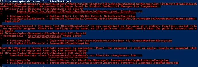

The script creates a library.xml that is fine but i get a few errors with the credentials.
I created a credential named plexcheck with username: my emailaddress and password.
But i stil get the following errors.
I think i did something wrong but don’t know what. Could you help me?
Greetings
What version of Powershell should I have installed?
Here’s the error I am getting. I’ve gone through the post and cannot send anything, I get the following error. I’ve tried with and out the arguments.
